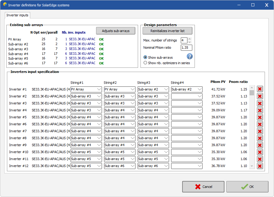

  • Then you push the button String Configuration. Here you get a list of "physical" inverters corresponding to your Sub-arrays definitions. For each sub-array of a same Inverter model, PVsyst will create inverters with reference to a given sub-array for each string input.
  • This is a proposition of PVsyst, taking the number of concerned inverters you have specified in each sub-array into account.
  • Now for each inverter, you can eventually modify the attribution of sub-arrays to each string input. The sub-array may be shown either as "names", or as number of optimizers / orientation.
  • When modifying sub-arrays attribution, this list will become incompatible with the choices you have done in the sub-arrays: an orange warning may appear, requiring that you push the button Adjust sub-arrays for updating the number of concerned inverters in each sub-array.
  • During this automatic construction, you can specify the maximum number of strings on each inverter. The construction will also take the maximum allowed PNomRatio for this inverter (usually 1.35 for normal inverters, and 1.55 for HD-wave technology).
  • If desired, you can reinitialize the inverter list, using these specified constraints: maximum number of strings on each inverter input, Maximum PNom Ratio for passing to the next inverter.
  • You can manually add or delete inverters (right-click on the sub-array ComboBoxes).
