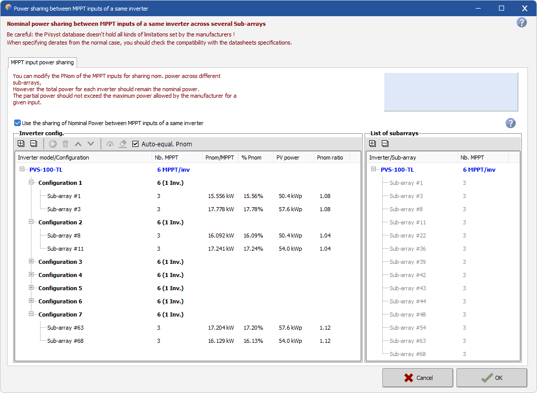

Power sharing window
In the "Power sharing" window, a list of all sub-arrays in your project is given in the "List of subarrays" tree on the right of the window. In this list, the sub-arrays are organized by inverter model.
Then, on the left, the "Inverter config." tree will allow you to gather sub-arrays under a same configuration number, by drag-and-dropping the sub-arrays from right to left to form groups.
Sub-arrays contained in a same configuration will be able to share their power (they will belong to a group of identical physical inverters). To share their power, you can either balance the Pnom ratios (will be done automatically if "Auto-equal. Pnom" is checked), or manually balance and/or adjust the power allocated to each sub-array (you will have to uncheck "Auto-equal. Pnom" first).
Note that only sub-arrays with the same inverter model can perform the power sharing among each other. You can create new configurations by drag-and-dropping a sub-array on the corresponding inverter node on the left, or by pressing the plus button. The needle gauge button also allows to equalize Pnom ratios with more granularity. Finally several buttons allow to clear the definitions (eraser button), as well as delete (trash button) and organize (up and down buttons) the groups.
This interface is an update on the previous interface, from version 7.2.15 of the software. The logic remains unchanged, but the new layout allows an easier management of the groups, and removes the cap on the number of sub-arrays.
Overall, the management of configurations is easy when you have only 2 kinds of MPPT (2 sub-arrays), since they will usually belong to the same single group. Things may be more difficult with 3 or more combinations, or non-equal numbers of inverter inputs in each sub-array: in this case PVsyst will check the feasibility of your choices and associations and may display some warning messages, but cannot always propose a general solution.

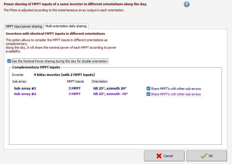

2 sub-arrays with different orientations (for example with "domes")
When you have 2 orientations, the array power in each orientation will evolve differently during the day. It may be interesting to use Multi-MPPT inverters, with one MPPT input for each orientation.
The maximum power of one orientation will not arise at the same time during the day, so that you can "undersize" the inverter.
In this situation, the PNom of each complementary MPPT input should be shared according to the hour of the day. This is done during the simulation: at each time step, the PNom of each MPPT will be adjusted according to the incident energy in each orientation.
The setup for daily sharing can be setup via the power sharing window, which will show a daily sharing tab.

How to solve common errors related to power sharing
The power sharing configurations in PVsyst must be unambiguous, realistic, and consistent with the PVsyst conventions. This is why PVsyst will perform several consistency checks on the numbers of strings, inverters, or MPPT inputs.
At first it is not always easy to set up power sharing properly. In this section we will outline the most common error messages displayed by PVsyst when setting up power sharing and we will explain how to fix them. Virtually every situation can be realized with PVsyst, but one may need several adjustments to satisfy the consistency checks.
Power Sharing between different Inverter Types doesn't make sense
This message indicates that you are trying to put in the same power sharing configuration two or more sub-arrays that do not have the same inverters. Since the power sharing can only happen between MPPT inputs of the same physical inverters, this is incorrect. You should go through each of the concerned sub-arrays and check that their definition has the same inverter model.
Errors concerning the number of strings, MPPT inputs, or inverters
The error messages in the following sections aim at guiding users towards an unambiguous configuration. Indeed, even though you may accurately select parameters to describe a specific situation that you have in mind, there may be other configurations that will share the same set of parameters.
For example, one of the current requirements in PVsyst is that when using the power sharing, all MPPT inputs of an inverter have to be used. Trying to configure a multi-MPPT inverter with one or more unused MPPT inputs will lead to an error message.
As another example, whenever there are more sub-arrays in a configuration than the number of MPPT inputs of a single inverter of the same configuration, PVsyst will not be able to decide what the situation means. This will trigger also one of the error messages.
NB: For these consistency checks, two sub-arrays are always considered different, even in the case where the contents of each sub-array are identical. In some cases, it may in fact be necessary to define identical sub-arrays, in order to properly define the power sharing configurations. Indeed two sub-arrays, while identical but may belong to different configurations.
