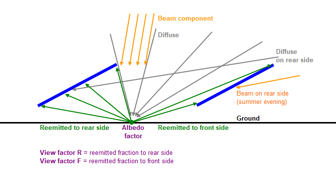

Irradiance on the rear side - View Factor
Now we have to evaluate the irradiance on the rear side of the PV modules. This will be characterized by the amount of irradiance re-emitted by the ground, which we name "Albedo".
The light remitted from a given ground point is the received irradiance, multiplied by the albedo factor of the ground. You can find some examples of usual Albedo factors here. However this parameter is very important in the bi-facial situation, and should be estimated with care for each particular system. It may change when the ground is wet, with snow, or with time (ageing of the surface), and even eventually with the sun's height. PVsyst doesn't take such changes into consideration in the present time, except that you can define seasonal values for the albedo.
Warning
Please do not confuse the albedo of the project with this albedo for bifacial. The albedo of the project characterizes the ground in front of the installation, far from the system. It is used in the Transposition Model and affects the GlobInc value. The albedo for bifacial is a property of the ground just below your PV installation.
A very important hypothesis of PVsyst is that the light re-emitted by a point of the ground has an isotropic distribution. This means that the light is re-emitted with the same intensity whatever the direction of the space (half-sphere above this point). There is no specular reflection. This is a lambertian distribution, i.e., each ray is multiplied by the cosine of the incidence angle.
We name "View Factor" (or "Form factor") the fraction of this light effectively reaching the PV module. This is again the result of an integral over all PV modules directions "seen" by this point. The light re-emitted to the sky is obviously lost. The View Factor is also a property of each ground point, only depending on the geometry. The distribution of view factors for any point is calculated only once.
In fact we have to evaluate 2 kinds of "View factors": one concerning the rear side of the collectors, and another one representing the irradiance reaching the front side. This last contribution will be added to the usual incident irradiance. This View factor integrals involve an IAM correction for each ray, which is of particular importance for the front side.
Besides these contributions, we also have to take the diffuse part directly seen by the rear side (again result of an integral), as well as the beam eventually falling on it (in the morning and evening in summer).
All the irradiance calculations for the rear side take into account the IAM losses and are always calculated using the simple Fresnel model for glass without anti-reflective coating.

Reflected Irradiance on the front side
From the diagram above, we see that there is a contribution of the albedo reflexion, reaching also the front side of the collector.
We can evaluate this contribution in the same way as for the rear side, by defining a View factor for the front side. This contribution is very low for low tilts, and is emitted by ground regions below the shed, which are weakly illuminated. But it may become significant when the tilt increases (especially for the vertical bi-facial case).
This contribution is evaluated during the simulation of bifacial systems, and is appearing on the loss diagram as "Ground reflexion on front side" (variable named ReflFrt).
