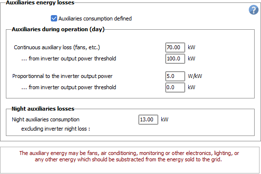

Auxiliaries losses in the simulation
The Auxiliaries consumption loss is defined in the "Detailed Losses" part. It is defined globally for the whole system.
It will be accounted in the simulation only when you check "Auxiliaries consumption defined".
This example (for a big system of 100 MW) shows:
During the day:
- there is a constant power loss of 72 kW, which will become active only when the system delivers more than 100 kW
- there is a consumption proportional to the system power delivery (e.g. adapting cooling device, evacuating the excess heat due to the inefficiency of the inverter), expressed in [W/kW]
Both contributions may be specified independently, they will be added.
During the night:
- The night consumption of the auxiliaries is fixed, 13 kW in this case.
This doesn't include the intrinsic night loss of the inverter, which is specified within the inverter's definitions, and leads to a specific loss of the inverter (named "IL_Night"), appearing only when it is significant (more than 0.01%).
The auxiliaries consumption loss - day and night - is accumulated in the variable named "Aux_Lss".
