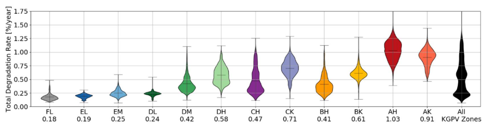

Climate influence
The average degradation rate of PV modules depends on external stress factors that are themselves climate-dependent:
  • Temperature (high, low, and large fluctuations)
  • Mechanical stress (snow, wind, sandstorms)
  • Moisture, humidity, salt mist (corrosion)
  • UV exposure
  • Soiling
The graph below from [1] shows the estimated degradation rate per Köppen-Geiger-Photovoltaic climate zone (KGPV). It illustrates that the coldest climates have the lowest degradation rates, while sunny tropical climates have the highest, reaching around 1% per year on average.
