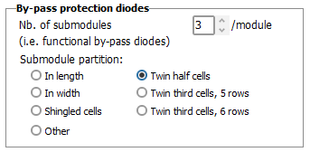

Definition in the PV module dialog
The architecture is a basic definition of the PV modules parameters (PAN files), useful especially when dealing with electrical shadings.
It is closely related to the number of cells in series. The typical voltage of modern crystalline cells is 0.56–0.57 V/cell. Therefore, the number of cells in series can be estimated using the specified Vmpp at STC.
Submodules_Layout
There are several other possible configurations. You can get them in an additional combobox, when checking "Others" in this dialog.
Submodules configurations description

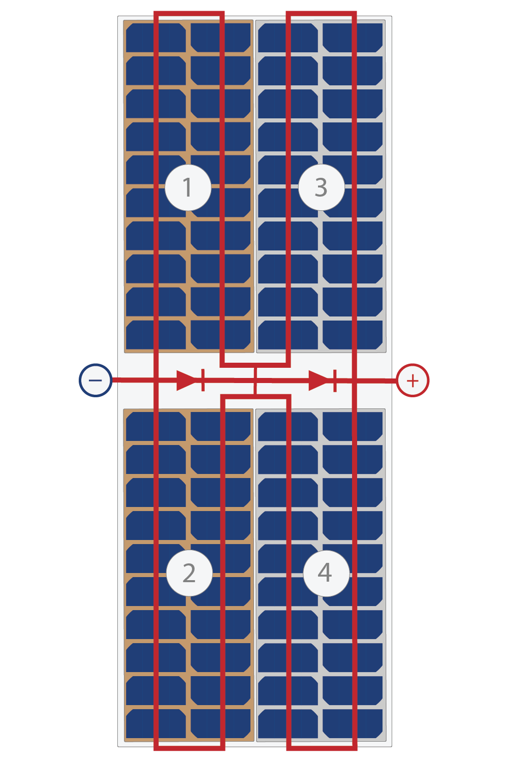

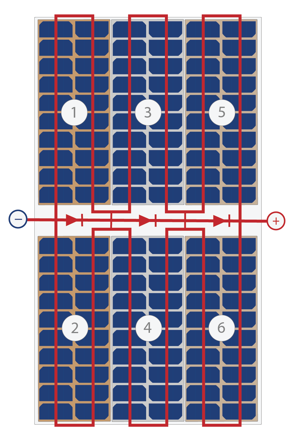

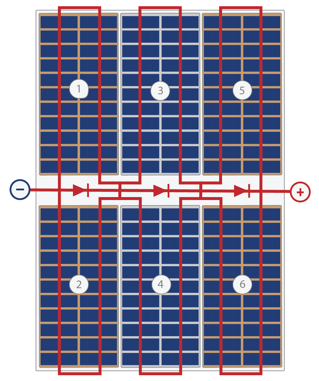

Alt text Twin half-cut cells
More and more modern modules are now organized in this configuration.
This uses series of half-cutted cells. Each submodule is made of a series of 20 or 24 cells, and 2 submodules are connected in parallel, with one common by-pass diode. The advantage is that when some cells are shaded in the bottom part, the upper part of the module is still active, minimizing the electrical shading loss. Therefore in a row arrangement, these modules should be used in portrait.
Each sub-module has 20 (or 24) cells in series. Therefore NCells in series = 60 (or 72), i.e half the total number of cells specified on the datasheets. And the number of cells in parallel is 2.
The global sizes of these modules are comparable to the equivalent modules "in length".
There are other technological advantages: this minimize the series resistance, and diminishes the risk of cracks.
This technology seems to favor the efficiency: modules of a same manufacturing processes get slightly better efficiencies.

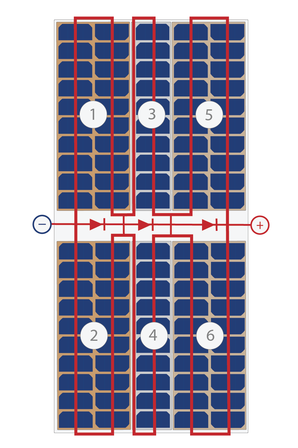

Alt text Alt text Twin third-cut cells, 5 rows
With the increase of the cell sizes (182 and now 210 mm), some manufacturers try to keep the PV modules close to usual sizes.
They diminish the number of rows (5 * 210 mm lead for about 1.1 m width) and use 1/3 of cells for limiting the lenght - and also the current.
The number of cells in series may be 22 + 11 + 22 (i.e. 55 cells) or 24 + 12 + 24 (60 cells), etc. It should be divisible by 5.
This configuration requires that for the central submodule, a copper connection strip leading the half-current of the module has to be deployed along the sub-module.

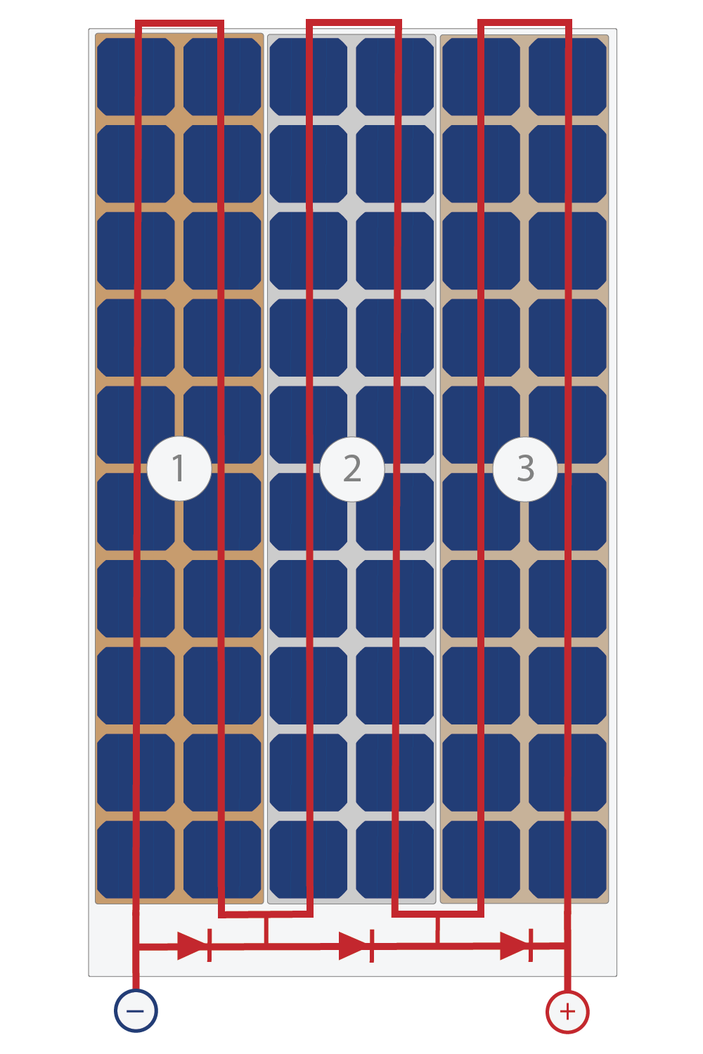

Alt text Twin half-cut cells, 4 rows
There are also some few narrow modules with 4 rows of cells, and therefore 2 by-pass diodes.
These seem to be especially designed for grid integration.

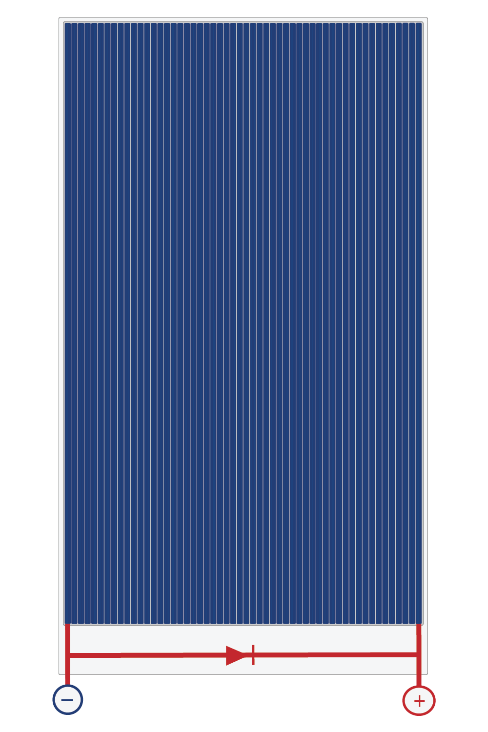

In the thin film modules (CIGS, CdTe, amorphous) the cells are strips of about 10 mm width, on the full length of the module.
In some cases, the strips may also be in the width of the module.
This means that the number of cells in series is closely related to the modules size (width or length).
Some Thin film modules have a very high number of cells (for example first Solar CdTe: 270 cells in series for a Vmpp around 185V).
Most of the thin film modules have one only by-pass protection diode for the whole module. This is because the connection from cell to cell is indeed distributed on the whole length of the cells, so that it is not possible to get a middle point connection. This is not a problem because a single cell is unlikely to be shaded.
When installed in a row-like system, the strips should always be disposed perpendicularly to the possible shades. In this way all cells will be partially shaded in the same way. Therefore the thin film modules are not suffering of electrical shading losses.
