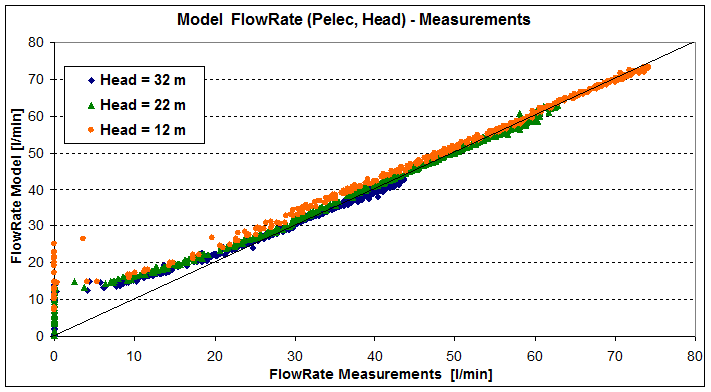

The results are impressive: The next figure shows a comparison between measured and modelled values, for the model established only on 3 operating points at nominal voltage, and for a wide range of operating conditions.
Pump_Model_Validation_Solarjack
Model validation on a Solarjack SCS-160 pump, CIEMAT Measurements (Abella, 20043)
Significant deviations are observed only at lower flowrates (powers). This is likely due to changes in converter and motor efficiency with power (or speed), which are not accounted for here.
