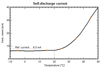

Self-discharge is temperature-dependent. PVsyst uses a temperature profile established for lead-acid batteries from discussions with a manufacturer. Self-discharge is stable at low temperatures and increases above 20°C.
Self discharge vs temperature
Lacking li-ion battery data, we apply the same temperature correction in our database. However, this contributes minimally to overall battery losses.
