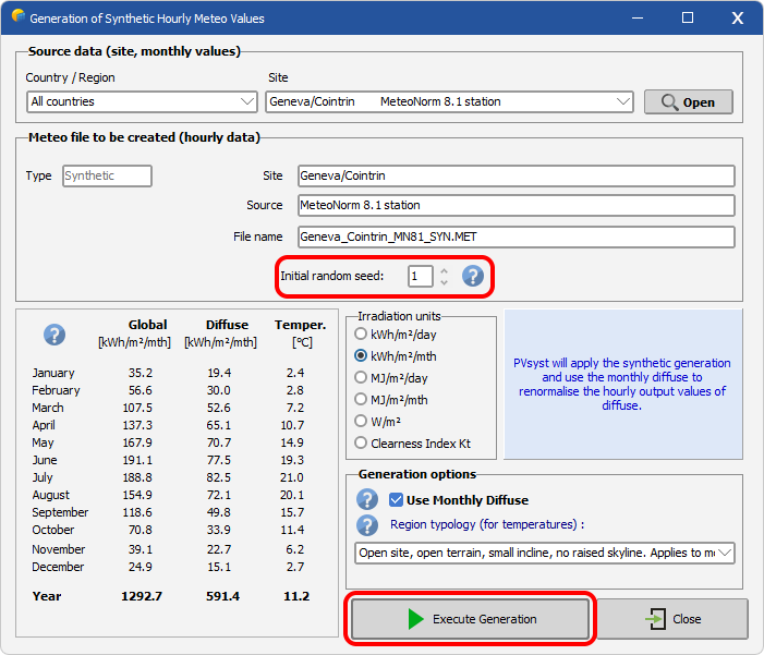

Execute generation
To get the synthetic hourly data from your monthly definitions:
- Select the Source data in the list, (you can verify if it is the site you want with "Open").
- Choose the First Random Seed (between 1 and 10).
- Press the Execute Generation button.
The "Use monthly diffuse" option is for information only and remains checked (follow the link).
The Region topology can be chosen from the list below (with examples from places in Switzerland). The effect of this choice is a slight variation of the generated temperature profile for the synthetic hours. More details here.
