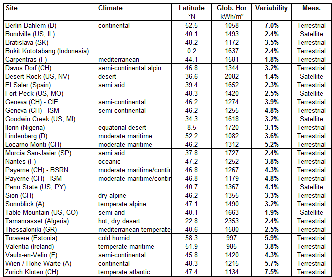

  • The variability of the weather data has been studied in detail by Pierre Ineichen for about 30 different sites, in a document available from our web site (cf Ineichen_20011)
    • He has collected data from different sources, and analyzed time series of 10 to 30 years for each of the 30 sites studied.

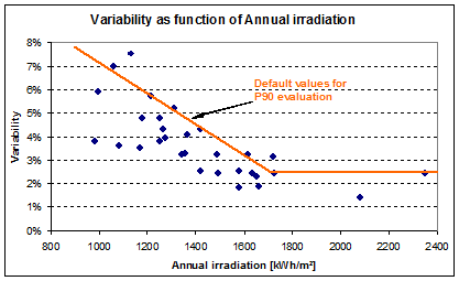

    • The main results are gathered on the table given below.
    • It appears that the variability is dependent on the annual irradiance: this may be explained by the fact that with sunny climates with many clear days, the possibility of middle or bad days is lower.
    • Therefore for use of these data in the evaluation of the P90 values, we have established an upper estimate which is used as default value.
