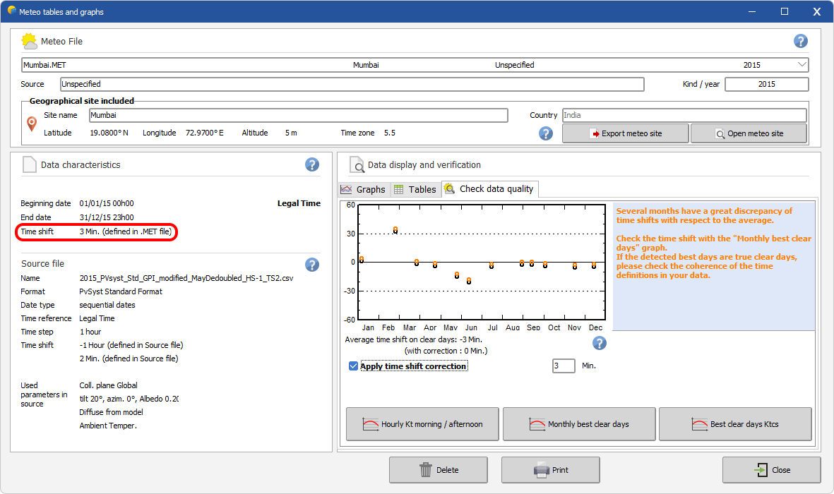

As an example, in the screen shot given below :
  • the user has first defined a -1 hour shift together with a +2 minutes time shift in a PVsyst standard file
  • they finally decided to set a +3 minutes time shift after considering the Check data quality tools of PVsyst.
  • the +3 minutes time shift is the value written in the .MET file. It will be applied during the simulation.

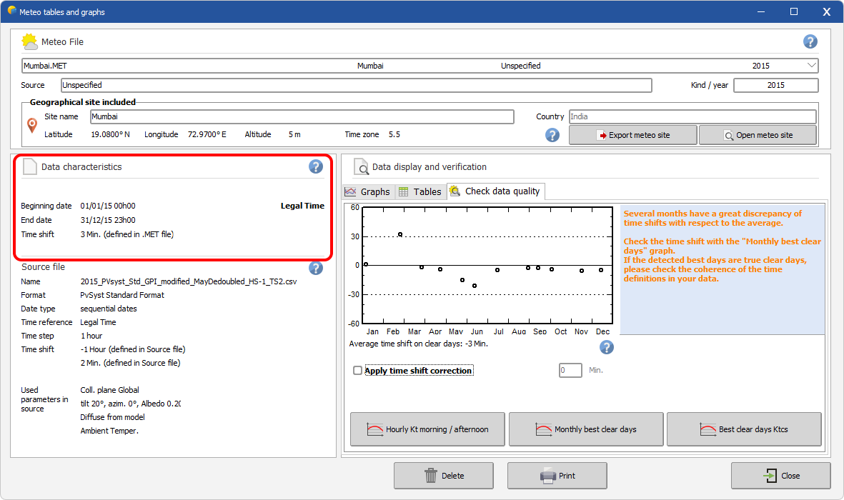

In the screen shot given below, the user decided not to apply the Time Shift defined in the source file. By doing so, PVsyst will not consider any minute shift during the simulation.
Dialog_Meteo_Database_MeteoTablesGraphs_DataCharsection_MumbainoTS

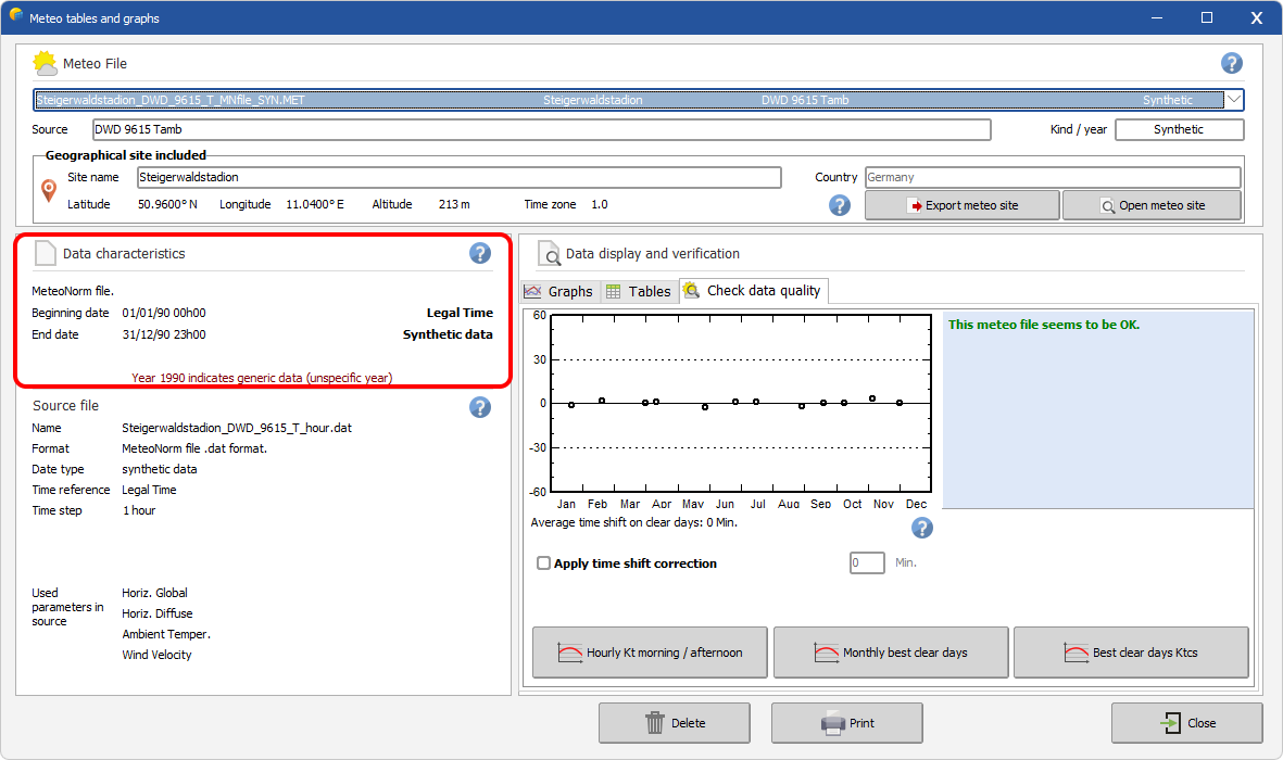

Synthetic data
The weather data may be synthetic, i.e. generated from a stochastic algorithm. Providers such as Meteonorm generate synthetic weather files. The label Synthetic data covers this specificity, as the year label 19901.
Dialog_Meteo_Database_MeteoTablesGraphs_DataCharsection_Synthetic

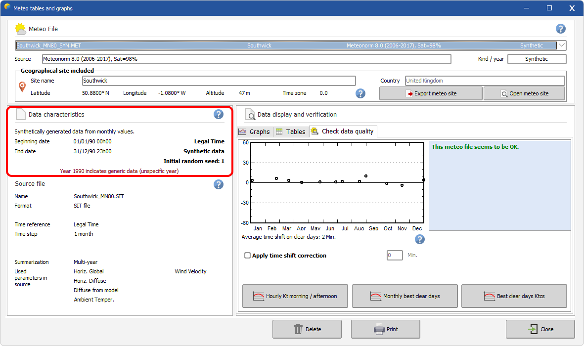

If the synthetic generation has been performed in PVsyst by the Meteonorm DLL, then the first random seed is indicated.
Dialog_Meteo_Database_MeteoTablesGraphs_DataCharsection_Year1990

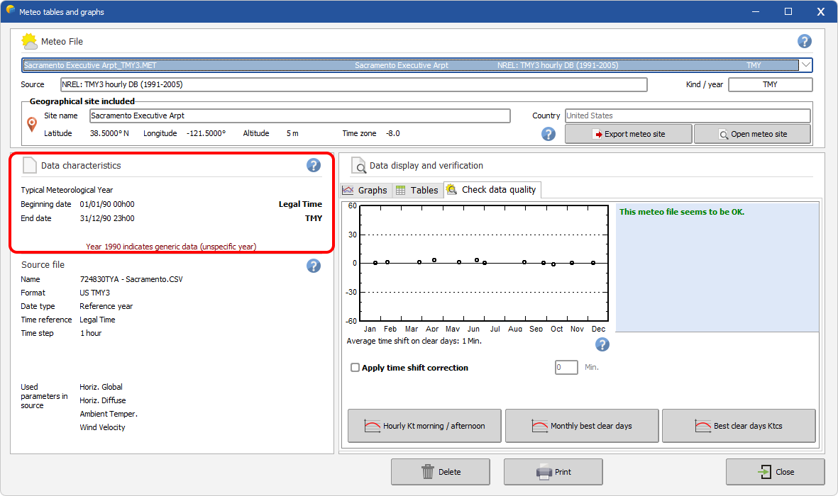

TMY
The label TMY holds for Typical Meteorological Years or Design Reference Years (DRY). As for Synthetic data, the year is stamped 19901.
Dialog_Meteo_Database_MeteoTablesGraphs_DataCharsection_TMY
