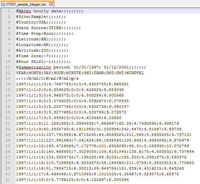

- Locations with Integer Time Zone:
- The first line is labelled 1h0 minutes, which means that data was accumulated "from 0h to 1h".
 - PVsyst reads the label 1h0 minutes as "from 1h to 2h",
 - and will consequently consider that the data is +1h ahead compared to the sun position.
- => Tag Hour shift;-1; required (means that a -1h correction will be applied when reading the data).

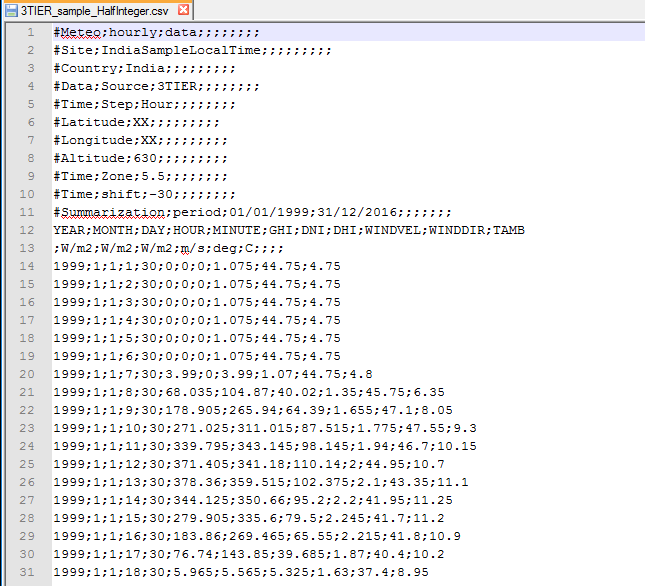

- Locations with half-integer Time Zone :
- The first line is labelled 1h30 minutes, which means that data was accumulated "from 0h30 to1h30".
 - PVsyst reads the label 1h30 minutes as "from 1h to 2h" (no reading of minutes),
 - and will consequently consider that the data is +30mn ahead compared to the sun position.
- => Tag Time Shift;-30; required (means that a -30mn correction will be applied when reading the data).
