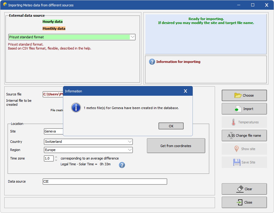

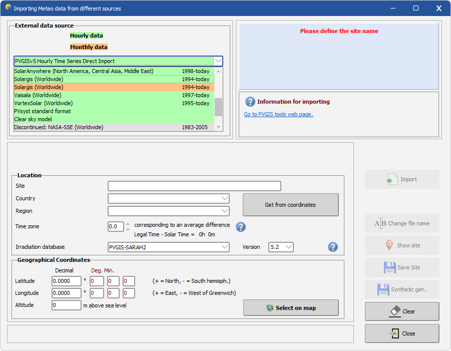

Step #1: In the Import weather data tool, select your External Data Source from the list. The list distinguishes hourly data and Monthly data. As mentioned above, the example for this tutorial is a file in PVsyst standard format. Then select your file by clicking on Choose.

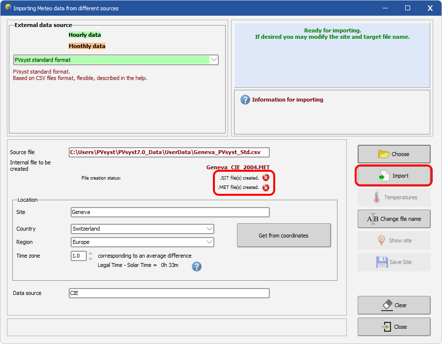

Step #2: The Import button will create the .MET file.

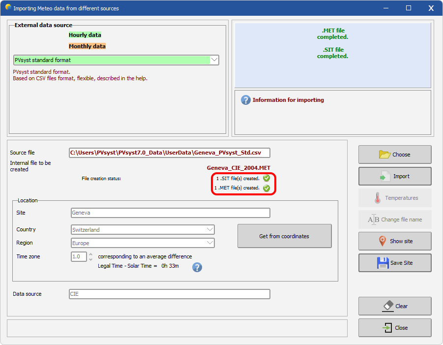

Step #3: PVsyst gives you a feeback of what was created.

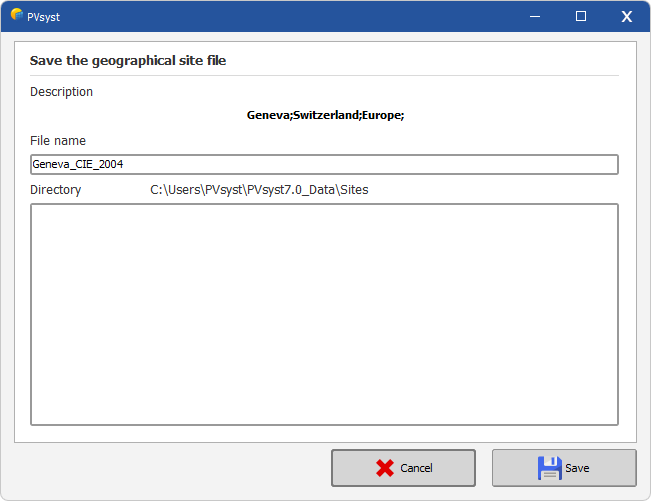

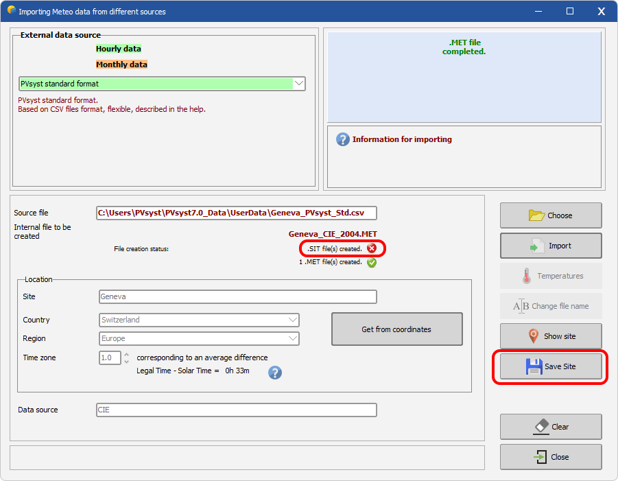

Step #4: If the geographical coordinates of the weather data file are the same as the project site coordinates, you need to create a *.SIT file. This *.SIT file will be used in the project section. To do so, click on the Save Site button.
Step #5: Save the geographical site
Step #6: PVsyst updates the feeback message
