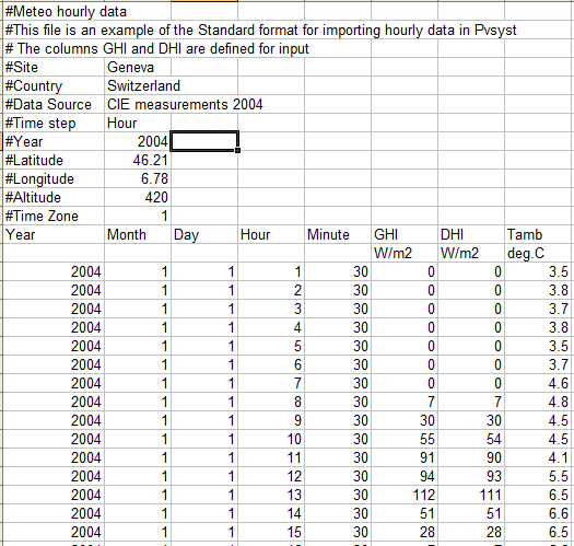

The PVsyst8.0_Data/Templates folder contains 2 examples of the PVsyst standard weather format csv files:
METEO_PVsyst_Standard_Geneva_GHI.CSVusing GHI and DHI as input (recommended)METEO_PVsyst_Standard_Geneva_GPI.CSVusing POA iarradiance

Example:
