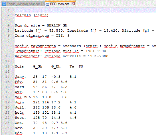

- Monthly values as ASCII files (named

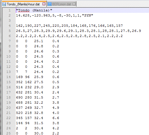

xxxxMON.DAT), which may be directly read by PVsyst for creating *.SIT file. - Hourly values as ASCII files (named
xxxxHOUR.DAT). The hourly data are built by a stochastic model, quite similar to the "Synthetic Hourly Generation" performed in PVsyst. The Meteonorm process also produces stochastic hourly wind values, when PVsyst only puts the monthly average wind speed. These data may also be directly imported in PVsyst.

\MeteoTest\Meteonorm\Outputdirectory) : - Monthly values: just save it as a file (default format), which will be named
xxxxMON.dat
- Hourly values: choose the special PVsyst output format before saving the file (main menu option "Format" / "Output Format", and choose PVsyst). This will create a file named xxxxHOUR.dat.

If you select a monthly file, this will create a Site (*.SIT) file in the database.
If you select an hourly file, this will create an hourly weather data file (*.MET). you have the possibility to create a Site file as well (*.SIT).

With Meteonorm V 5.0 and 5.1 the format of the monthly output file is erroneous. The "*MON.Dat" files don't include the site name nor the geographic coordinates. With these versions you should use the import in hourly values, which works quite well.
With Meteonorm V 4.0, the same problem arises when you ask the construction of hourly values. Please save the Monthly values before constructing the hourly ones.
