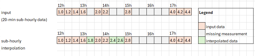

Missing sub-hourly values
When importing a sub-hourly file, gaps of less than 1 hour will be interpolated linearly from the 2 closest values. Gaps of more than 1 hour will not be filled.
Illustration for a 20 min time step file:
Diagram showing linear interpolation of sub-hourly gaps shorter than 1 hour, with larger gaps left unfilled

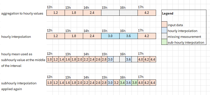

Missing hourly values (1-4 hours)
In case of full hour(s) of data missing (both for hourly and sub-hourly data file imports) the gap filling scheme will depend on the variable considered:
  • GlobHor or GIPMeas (POA) missing: These gaps are not filled during the day as correct irradiance is critical to PVsyst simulation. Missing night values are simply set to 0. Missing day values will be flagged in yellow in the data tables. It is not advised to run simulation with incomplete irradiance data.
  • DiffHor or DNIMeas missing: The diffuse irradiance will be computed from the GlobHor value (if available) using a diffuse irradiance model For all other variables (temperature, wind, etc), hourly values will be filled by linear interpolation. If the input is a subhourly file, the corresponding subhourly values will be filled by linear interpolation as well.
Diagram showing the hourly gap filling scheme for 1 to 4 hour gaps, with linear interpolation applied to non-irradiance variables
