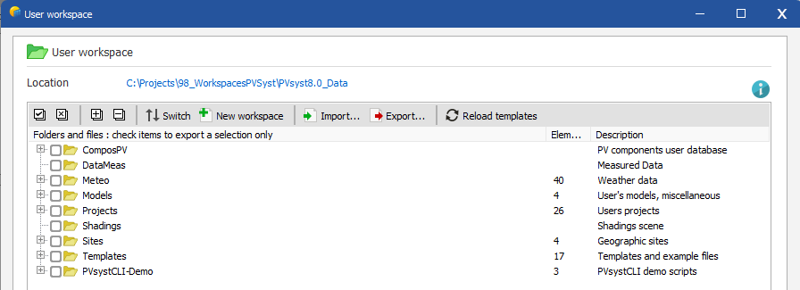

The current workspace used by PVsyst is displayed on the main screen:
Clicking on Manage or File -> Workspace opens the workspace management window:
Several actions can be done on workspaces:
- Switch to another existing workspace.
- Create and switch to a new empty workspace.
- Import an existing workspace and switch to it.
- Export the current workspace to a zip file.
- Reload templates and PVsystCLI examples
