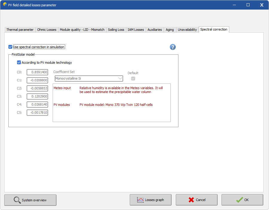

The FirstSolar spectral correction model is switched on in the dialogue 'Detailed losses':
When the spectral correction is enabled, the coefficient set corresponding to the PV module technology is used by default in the simulation. It is possible to override this behavior by un-checking the corresponding box and selecting any of the available coefficient sets. In this case, the coefficient set will not follow any more possible changes of the PV module in the system definitions, and it is the responsibility of the user to ensure that a meaningful set is chosen for the simulation.
