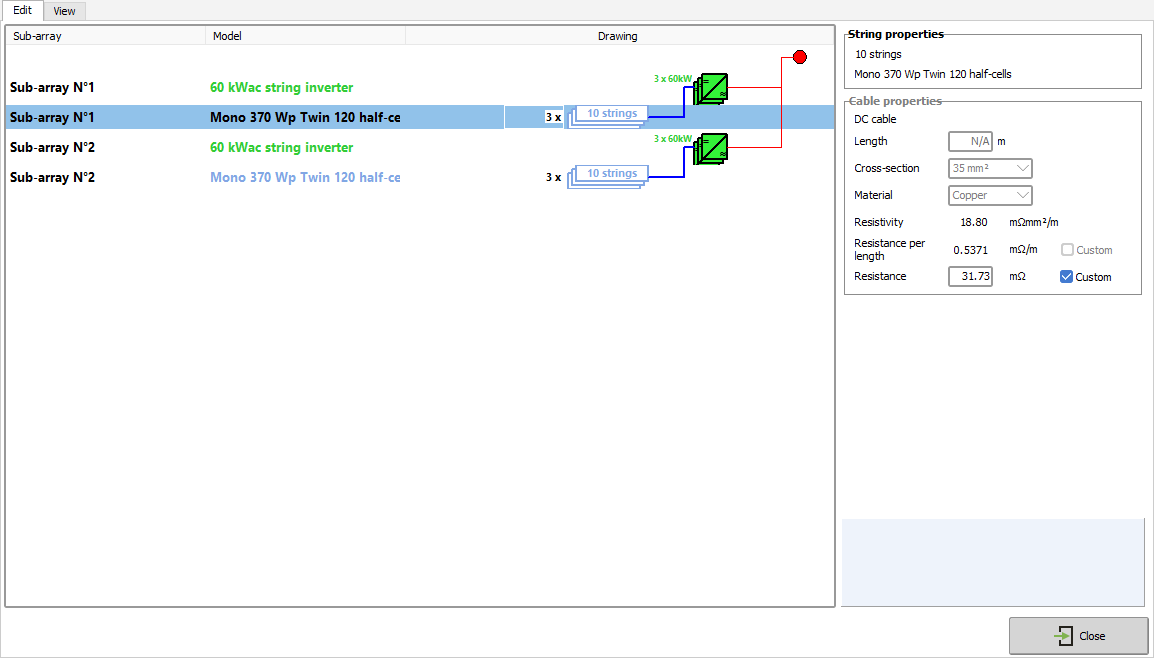

Single line diagram editor
The editor of the single line diagram allows to see the tree structure of the system circuit on the left side. The properties of the selected node are displayed on the right side.The different nodes are the components like strings, inverters, combiner boxes, transformers, and so on. They are connected by cables which are drawn in blue for the DC part of the circuit and in red for the AC part. Each node is a line in the tree view with two column entries on the left. The first column indicates the sub-array from 'System' to which this node belongs. The second column contains information on PV module and inverter types.
Each node has a single set of outgoing cables that link it to its parent node. The cable properties displayed on the right side are always the properties of the outgoing cables of the selected node.
Single line diagram editing tab
Currently the editor allows only a very reduced number of operations on the circuit, mainly consisting in grouping or un-grouping the nodes. In future PVsyst versions this options will increase and eventually it will become possible to edit the components from within this circuit view. So far there is no undo-function in the editor, we therefore recommend to be careful with the ungrouping functions, as they may lead to large trees that are difficult to work with.
The nodes can represent a single object or groups of several objects. The grouping is only possible if the nodes are identical, including all its children. The properties of the different types of nodes are explained below. If the node consists of a group of components, the children nodes are shown only once. To make clear that each of these children exists in each component of the group, the multiplicity is shown left to the child node. In the example above, there are two groups of three inverters each. Each inverter has a group of ten strings connected to it. The transformer nodes are an exception to this, if they represent a group, all children will be represented in the diagram (see also the explanation of transformer nodes in the following).

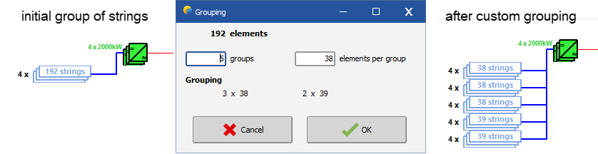

When selecting 'ungroup', the program will split a node into nodes with single elements. For nodes with many elements this is not very practical. In these cases, the function 'custom group' allows you to reorganize a node or a selection of nodes into a given number of groups. When selecting this function, a small dialog pops up which allows to regroup the elements. You can either provide the number of groups that should be created, or the number of elements that should be in each group. If the total number of elements is not a multiple of these two figures, then two kinds of groups will be created, which will differ only by one in the number of elements.
Example:
In the following example a node with 192 elements, strings in this case, is split into five groups. As can be seen, this results in 3 groups of 38 strings and two groups of 39 strings, making for a total of 192 strings. Note that this grouping result is now set for all four inverters in this example. Ungrouping the inverters would yield 4 inverter nodes, each one with 5 groups of strings identical to the right side of the example.
If instead of choosing the number of groups, we would have entered 38 for the number of elements, the grouping would have been done differently. The algorithm builds as many groups of 38 elements as possible, and puts the remaining elements, if any, into one separate group.
