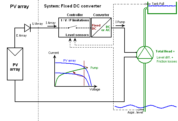

Use of a DC-DC converter (Power Conditioning Unit) shows a much favourable figure than direct coupling. This cheap electronic device absorbs the power of the PV array at a fixed voltage, and behaves as a current generator for feeding the DC-motor of the pump.

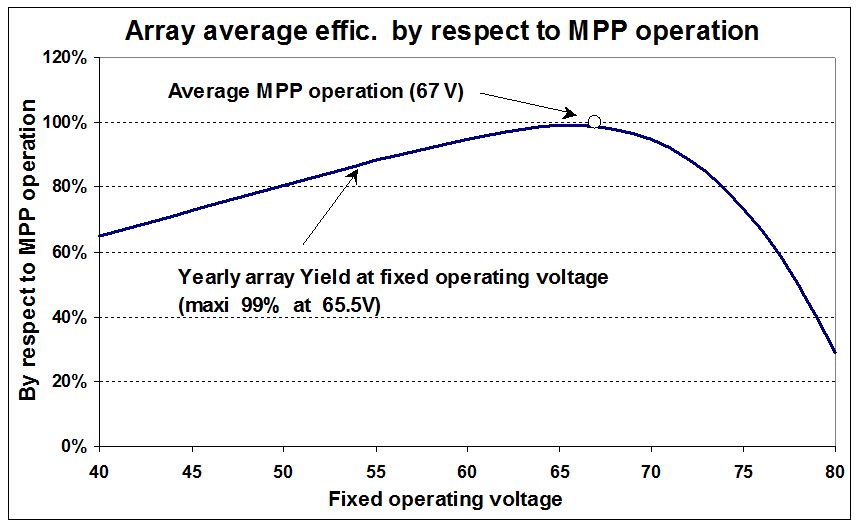

At the input side, the voltage may be chosen close to the maximum power point, and stays quite near for any irradiance. On most commercial DC-DC devices, the input voltage may be adjusted by hardware. PVsyst includes a specific tool optimisation for determining the optimal DC voltage setting.

At the output side, the power is supposed to be transmitted to the motor at the optimal current/voltage point corresponding to the available power.
For AC pumps, a PCU (DC or MPPT converter) suited for a given pump is usually proposed by the pump's manufacturer. It is supposed to fit the inputs requirements (voltage and frequency) for proper operation.

You can have a look on the Results, which confirms that the Fixed Voltage DC technology gives performances approaching the MPPT, and is not very sensitive to the fixed voltage.
