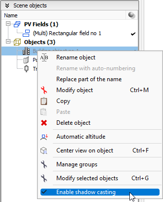

You can also use the contextual menu from the objects tree:
EnableShadowCasting

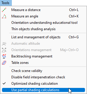

To do so, you must first enable the partial shading calculations from the menu "Tools > Use partial shading calculations".
EnablePartialElectricalCalculations
