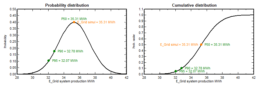

P50_P90_Prog
PVsyst shows a graphical representation of your choices, either as a Gaussian probability distribution for several years, or as the corresponding cumulative distribution (the integral of the gaussian).
On this example, the simulation was performed using a specific year, which was supposed to be -3% below the yearly average. Therefore the P50 value is higher. A  positive climate evolution would have the same effect.
Playing with the uncertainty parameters is highly instructive about the representativity of the simulation result for the future years. It is interesting to observe that according to your interpretation of the simulation result (i.e. E_Grid, fixed), the forecast productions distribution may move around your simulation result !
