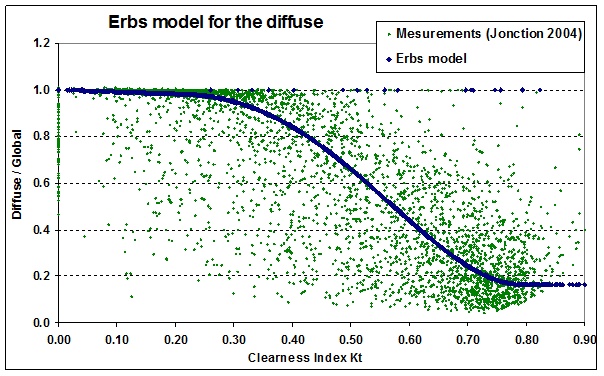

In PVsyst the diffuse irradiation uses a "Liu and Jordan-like" model which is the Erbs correlation (Erbs et al, 1982). When applied to our data from the SIG (the only simultaneous measurement of global and diffuse irradiations we have at our disposal), this correlation gives good results with an MBE of 1.7% and a RMSE of 27% (with respect to the value of the diffuse irradiance), or 13% (referred to global irradiance).
