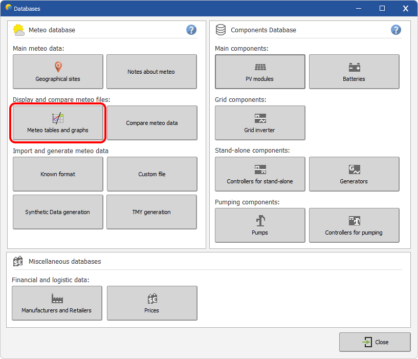

The  "Meteo Tables and Graphs" section of PVSyst displays the contents of the meteorological hourly *.MET files and provides several tools to evaluate the quality of data.
Contents of the MET file are :
•The list of imported parameters, with the reference of the source file, and with possible additional parameters coming from other sources.
•Derived values like the beam component, the clearness index Kt, or the global irradiance on a tilted plane.
•Other characteristics : time reference of the MET file, time shift with respect to clear day model.
•The meteo site, which gives the coordinates of the location where the data was measured (or interpolated).
•Hourly, daily or monthly Tables and Graphs.
Dialog_Meteo_Database_Meteotablesandgraphesbtn
