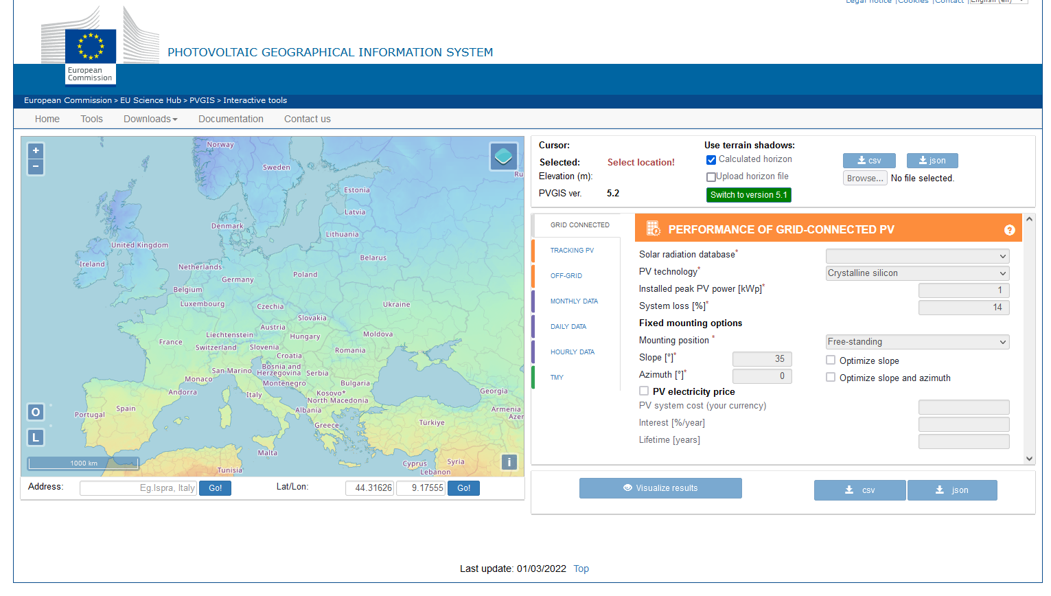

( PVGIS data are noy only accessible on creation of a new geographical site, go to Creation of a new site > Import PVGIS TMY )
PVGIS (Photovoltaic Geographical Information System, https://joint-research-centre.ec.europa.eu/pvgis-photovoltaic-geographical-information-system_en) is a research, demonstration and policy-support instrument for solar energy resource, and it is part of the SOLAREC action at the JRC Renewable Energies unit of the European Communities (Ispra).
You will find a complete description of this project at https://joint-research-centre.ec.europa.eu/pvgis-photovoltaic-geographical-information-system/getting-started-pvgis/using-pvgis-frequently-asked-questions_en
[Meteo_PVGIS_Data]welcomepage
PVGIS gives monthly irradiance data need to be further transformed to an hourly base for PVSyst.
