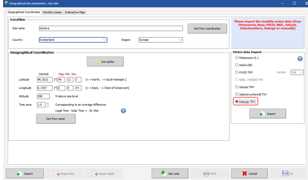

Within the geographical site parameters, select the Solargis TMY meteo data Import option, and click "Import":
SolargisAPISite
Refer to https://solargis.com/products/evaluate/tech-specs for more details on coverage. The Solargis TMY option in PVsyst is currently available from latitude -60° to +60°.
Please check directly with Solargis for higher latitudes.
