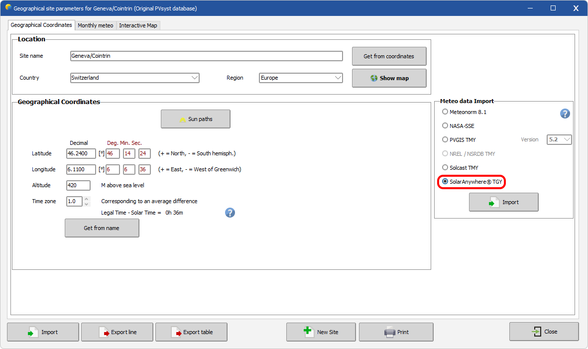

SolarAnywhere API Data Import
Within the geographical site parameters, select the SolarAnywhere® TGY Meteo data Import option, and click "Import":
Geographical_Site_Parameters_Geographical_Coordinates_SolarAnywhere

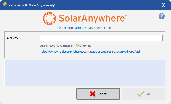

To import SolarAnywhere® TGY data, user registration is required.
Dialog_Meteo_SolarAnywhere_Register
•API key: enter existing SolarAnywhere® API key.
Learn how to create a SolarAnywhere® API key at https://www.solaranywhere.com/support/using-solaranywhere/api.
If you have forgotten the API key, are having difficulty signing up or want more information, please contact SolarAnywhere® directly at support@solaranywhere.com. Visit the SolarAnywhere® Support Center (https://www.solaranywhere.com/support-center) to learn more about the SolarAnywhere® model.

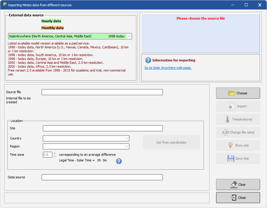

SolarAnywhere Data Files Import
Download SolarAnywhere® data from data.solaranywhere.com using the SolarAnywhere® output format.
Follow these steps to import SolarAnywhere® data into PVsyst:
1.Open PVsyst and select “Databases”.
2.Select “Known format” under “Import and generate meteo data”.
3.Select the SolarAnywhere option from the “External data source” drop down menu.
4.Choose the SolarAnywhere® file, fill in “Country” and “Region”, then select “Import”.
Dialog_Meteo_Database_Importmeteodata_SolarAnywhere
Visit the SolarAnywhere® Support Center (https://www.solaranywhere.com/support-center) to learn more about the SolarAnywhere® model. Contact SolarAnywhere® directly at support@solaranywhere.com with any additional questions.
