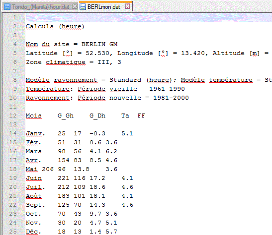

•Monthly Values  as  ASCII files  (named xxxxMON.DAT), which may be directly read by PVsyst for creating  *.SIT file.

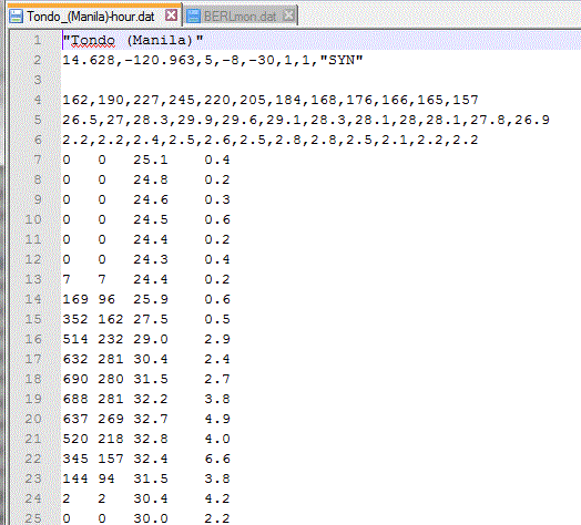

•Hourly Values  as  ASCII files  (named xxxxHOUR.DAT). The hourly data are built by a stochastic model, quite similar to the "Synthetic Hourly Generation" performed in PVsyst. The Meteonorm process also produces  stochastic hourly wind values, when PVsyst only puts the monthly average wind speed. These data may also be directly imported in PVsyst.

•Monthly values: just save it as a file (default format), which will be named   xxxxMON.dat
•Hourly values: choose the special PVsyst output format before saving the file (main menu option "Format" / "Output Format", and choose PVsyst).  This will create a file named   xxxxHOUR.dat.

With Meteonorm V 5,.0 and 5.1 the format of the monthly output file is erroneous. The  "*MON.Dat"  files don't include the site name nor the geographic coordinates. With these versions you should use the import in hourly values, which works quite well.
