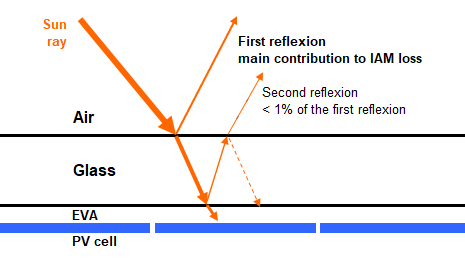

The transmission loss is a general phenomenon, due to the reflection and transmission of the sun's ray at each material interface (air-glass, glass-EVA, EVA-cell), as well as some absorption in the glass. This arises for any incidence ray. For normal incidence, the reflexion is of the order of 5%, and is included in the measured STC performance. The IAM only concerns the angular dependency of this effect, i.e. it is normalized to the transmission at perpendicular incidence (0° incidence angle).

In principle, this phenomenon obeys the Fresnel's Laws describing transmission and reflections at the interface of two transparent materials of different refraction indexes n1 and n2.
This is a very general behavior, derived from the general Maxwell's equations describing all electric phenomena. The Fresnel's laws are first applied to the air-glass interface, they describe the reflected ray and the transmitted ray. For the transmitted ray, it is applied to the interface Glass-EVA, and so on.
These laws allow to calculate the light effectively reaching the cell's surface below the protective layer (usually glass), as a function of the incidence angle.
Now you can add an anti-reflective coating on the top interface air-glass. This thin layer has a lower refraction index than the glass, which limits the first reflection.

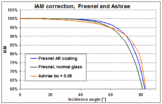

In the past, the IAM function has often been estimated using the "ASHRAE" parametrization (proposed in the years 80's by this American norm organism), depending on one only parameter bo:
FIAM = 1 - bo · (1/cos i - 1) where i = incidence angle on the plane.
For single-glazed thermal solar modules, the usually accepted value for bo is of the order of 0.1. But in a PV module, the lower interface, in contact with the cell, presents a high refraction index and our specific measurements on real crystalline modules actually indicate a value of bo = 0.05.

Up to the version 6.66, the Ashrae parametrization was used as default in PVsyst, whatever the module characteristics.
However since the version 6.67, PVsyst gives the opportunity of specifying the kind of glass interface (Normal glass, Anti-reflective coating, structured glass or plastic).
And attributes a default model according to this specification:
| - | All old modules (already defined in the database by version 6.66) remain with the Ashrae parametrization. |
| - | The new modules with "Normal glass" or "Plastic" will use the normal Fresnel calculation. |
| - | The new modules with "AR coating" or "Textured glass" will use the Fresnel calculation with AR coating. |
The next figure shows the IAM function for these 3 models:
We observe that the Ashrae parametrization underestimates the IAM value at medium angles (30 to 60°) and overestimates them over these values.
