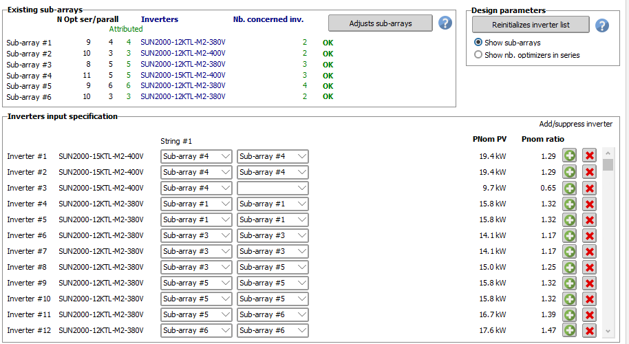

Now with your definitions, PVsyst tries to distribute your strings on real physical inverters inputs.
If the system is complex it is sometimes not possible within the rules. In this case the button "String configuration" is read, and you have to adjust this distribution manually.
Real inverters: button  "String configuration"
This dialog allows to define exactly the string inputs to be attributed to each physical inverter.
This distribution is normally proposed by PVsyst, but it may suffer of some incompatibilities with the rules. If so, you have to adjust the inverter's inputs for matching your wishes and the compatibility with the rules.
You can:
•Change the string attribution of any inverter. Each combobox  contains the compatible Subarrays with this inverter.
•Add an inverter if necessary  (specific button, or right-click on the inverter.to be replicated
•Suppress an inverter (button or right-click),
•The button  "Reinitializes inverter list" allows to retrieve the PVsyst proposition.
Now if you modify the strings attributions, this may become incompatible with the Subarrays defined in the "Systeme" part. The button "Adjust subarrays" will update the Subarray definitions according to your modifications.
