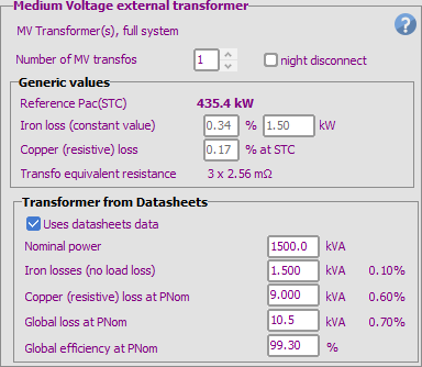

In the 'Detailed losses -> Ohmic losses' dialog, you have the possibility to define the following configurations:
- One or several Medium Voltage transformers for the whole system. PVsyst will distribute equally the power output of all inverters to all transformers.
- One Medium Voltage transformer in each sub-array. The transformer properties may be different in different sub-arrays, but each sub-array has to have one transformer.
- There is the possibility to add a High Voltage transformer that steps up the voltage before the injection point.
Transformer definition
The main losses associated with a transformer are:
- The iron losses, which are mostly due to hysteresis and eddy currents in the transformer core, are proportional to the square of the core flux, i.e. to the square of the voltage. Since the grid voltage is constant, this will also be a constant loss. As default value, PVsyst will use 0.1% of the reference nominal power.
Night disconnect: The iron loss remains active and constant as long as the transformer is connected to the grid, and this may represent a significant energy loss. In the simulation results, this will show up as negative a E_Grid system yield during the night. It may be economically profitable to foresee a switch that disconnects the transformer from the grid during the night. To activate this behavior in the simulation, please check the option "Night disconnect" next to the number of transformers. This option is global for all transformers in the system.
- The ohmic losses, also named copper losses, are originated by the resistance of the primary and the secondary windings of the transformer coils. These may be represented by a single equivalent resistance R, and in the simulation this loss will be computed as R * I² . Like for the cable losses, this means that the relative loss is proportional to the current (or power).
Generic values
Similar to the approach in the cable losses, PVsyst proposes a generic initial Ohmic loss relative value, for the early stage of the project's development.
This is defined as a percentage loss with respect to the reference nominal power, i.e. either PNomPV(ac) or PNom(Inv).
Datasheets definition
You can also define the real parameters of the chosen transformer (recommended).
The main information required is the Nominal power, the Iron loss (often named "no load loss") and the Copper loss.
The datasheets may specify either the global loss at PNom, or the global efficiency, from which PVsyst will deduce the copper loss.
Defining the real parameters from the Transformer's datasheet will fix the Generic values.
