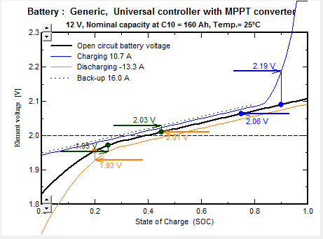

Current effects
Another problem arises from the charging or discharging current through the internal resistance.
PV array Charging control: On the figure below, we can observe that the charging disconnect condition is rather easy, as the voltage slope is enhanced by the "gassing" phenomenon (dissociation of the electrolyte), which adds a significant voltage "loss".
However when the controller switches OFF, the battery voltage brutally drops to the "linear" behavior (or more exactly a curve corresponding to the discharging current if a load is connected). The reconnecting voltage should of course not exceed this voltage, otherwise the system will oscillate.The reconnecting voltage is very difficult to establish and optimize, because we move on the linear SOC region with low voltage variation, and the controller doesn't "know" the load current. When the system attains the reconnecting point, it will jump to the blue charging curve.
NB: The "Gassing" region is a dangerous mode for the battery, as it will consume some electrolyte. This is the reason why the disconnect recommended thresholds are usually lower for sealed batteries, because you cannot refill the electrolyte. Usual recommended values for max. charge disconnect are 2.28 V for open and 2.25 V for sealed lead-acid batteries at 20°C. However this is not the exact values we will put as default in PVsyst, as we are not sure that the battery model of PVsyst exaclty reproduces the actual voltage of all real batteries. Moreover, this value is also dependent on the charging current and the internal resistance.
For the reconnect threshold, the choice is more difficult. We did not identify reliable general recommendations in the literature.
PV array new charging strategies: modern controllers are now able to regulate the charging current using PWM techniques. When attaining the maximum charging voltage, they will limit the current for keeping a constant voltage (floating mode). In a solar system, this is very useful for compensating the load current if any: the PV array will provide the required load current, ensuring a null current in the battery.
Connecting several controllers in parallel (each one connected to one PV sub-array) may have a similar effect: as soon as one of these devices reaches its own threshold, it will switch off its array, and the global battery voltage will drop accordingly, delaying the switching of other controllers, and ensuring the PV production for satisfying the load if any. The PVsyst simulation acts in this way.
NB: In these situations, the Disconnecting threshold should be significantly reduced (below the Gassing region), otherwise we can have a "constant" gassing state which will consume a lot of electrolyte.
Load disconnect control: when approaching deep depth of discharge the PVsyst battery model also defines an enhanced voltage drop, which facilitates the decision of switching OFF. However this voltage is highly depending on the discharge current, especially for batteries with high internal resistances. Again, when disconnecting the load the voltage will suddenly increase, and we should be sure to specify a sufficient hysteresis for the reconnecting threshold, at least above the orange point, for avoiding oscillations.
The reconnection should ensure a significant SOC increase, but the reconnection voltage is extremely sensitive (18 mV for a SOC variation of 0.1), and the uncertainties due to the temperature and other phenomenons is important. .
Back-up generator management: when a genset is managed by the controller, the start of the genset should arise before cutting the load for deep discharge of course ! Therefore the BackUp ON threshold should be above the Discharge OFF voltage condition. Again, the reference point for starting the genset is situated on the orange curve.
But the stopping voltage condition will take place on the blue dotted line. As the current provided by the genset is usually rather high, the stopping threshold should take the voltage drop of the charging current into account. Avoiding oscillations and ensuring a reasonable recharge will require a big hysteresis !

You have now a visual tool for a deep analysis of the voltage thresholds and the relationships between the the voltage (at different temperatures) and the SOC thresholds.
Please observe that we have 3 different Threshold variables:
| - The VThreshRef | value is the reference switching voltage specified for the reference temperature of the battery. |
| - The VThreshEff | value is the effective switching voltage at the real (measured or simulated) battery temperature. |
| - The SOCThresh | value is the corresponding SOC of the associated battery, depending on the temperature and current. |
The tool (diagram above) shows that the relations between these 3 values are the following:
| - | The difference between VThreshEff and VThreshRef is only related to the Controller's temperature coefficient |
| - | The SOCThresh with respect to the VThreshEff is "a priori" only dependent on the Battery Current. However if the battery temperature coefficient is not the same as the controller's one, there will also be a temperature dependency. |
| - | The SOCThresh with respect to the VThreshRef is depending on both the temperature and the currents. |
You are advised to play with these parameters for a better understanding of the relationships and their consequences.
