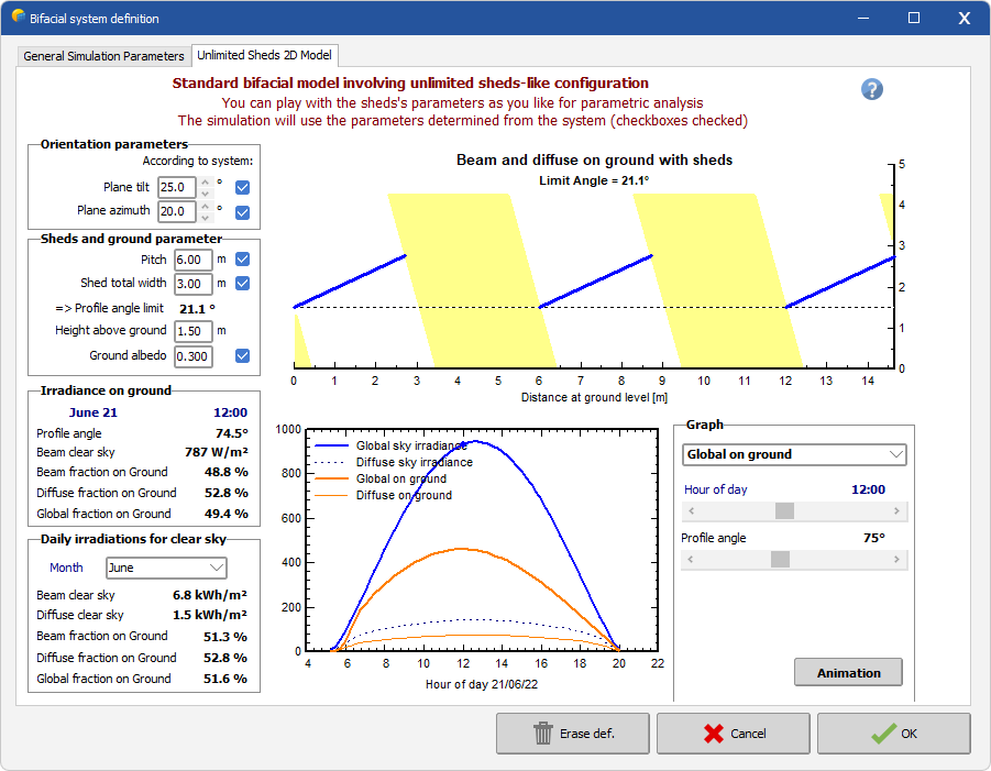

2-dimensional calculation
The "unlimited sheds" hypothesis allows a simple analytic calculation of the shed's behavior, namely the mutual shading from shed to shed, considering one only direction.
This also simplifies the bi-facial calculations: we can consider just the ground points distribution along the azimuth line, and we can analyze their behavior in terms of the shed's configuration.
Therefore, this dialog is also a powerful tool for the understanding of the bifacial systems issues, and its configuration optimization.
For this calculation, we have to specify the sheds parameters (Plane Tilt/Azimuth,  Pitch, shed width, height above the ground), as well as the Ground albedo.
You can play with these values as you like, and get evaluations of many parameters in diverse conditions. However at simulation time, the parameters as close as possible from the basic systems will be used.
The dialog shows:
-The basic parameters of the sheds disposition,
-An evaluation of the ground irradiance for some specified dates (clear day),
-An evaluation of the daily irradiance values for each month (clear day conditions),
-A drawing - with animation - of the sheds  and ground irradiance behaviors (beam, diffuse acceptance, ground re-emission, etc),
-Some distributions of  parameters, see below.
Sheds2DdDialog

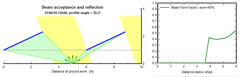

Beam acceptance on ground: this highly varies according to the season. Here for November at latitude 43° North  (instead of June just above):
BF_BeamNovember
Beam on Ground, and reflected : only a part of the illuminated ground re-emits to the collectors.
BF_Beam_Reflected

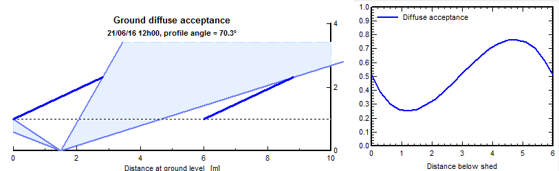

Diffuse acceptance: depends on the position of the ground point below the sheds.
BF_Diffuse acceptance
