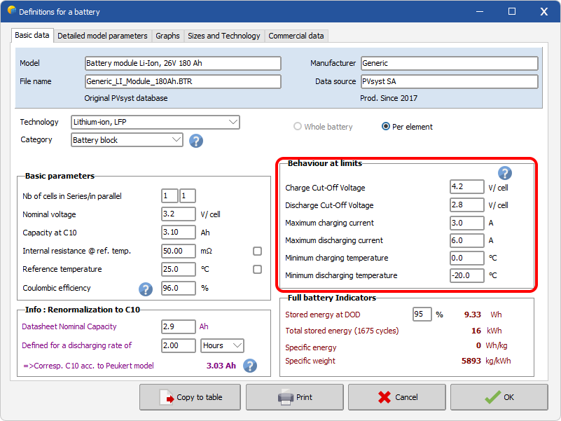

Behaviour at limits:
This group defines the absolute operating limits of Li-Ion batteries:
| - | Charge Cut-Off Voltage specifies the maximum allowed voltage when charging. |
| - | Discharge Cut-Off Voltage specifies the minimum allowed voltage in discharge state. |
| - | Minimum charging temperature, as specified in datasheets (for information only) |
| - | Minimum discharging temperature, as specified in datasheets. This parameter is used to challenge the internal resistance model at low discharge temperature. |
| - | Maximum charge current, as specified in datasheets (for information only) |
| - | Maximum discharge current. This parameter is usually taken from datasheets. It can be modified for cells available in the internal database: PVSyst applies a consistency-check of the voltage model, and if the discharge voltage at minimum temperature and maximum discharge current falls below the discharge cut-off voltage, then the maximum discharge current will be limited. This mechanism keeps the coherency of the whole dataset. |
