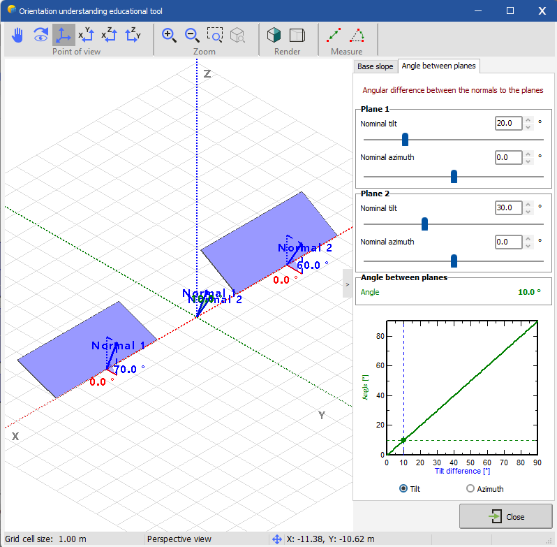

PVsyst includes a dedicated educational tool to aid users in comprehending the base slope effect. From the 3D scene menu, select "Tool" and then "Orientation Understanding Education Tool". This tool is designed to visually demonstrate how changes in panel inclination affect orientation.

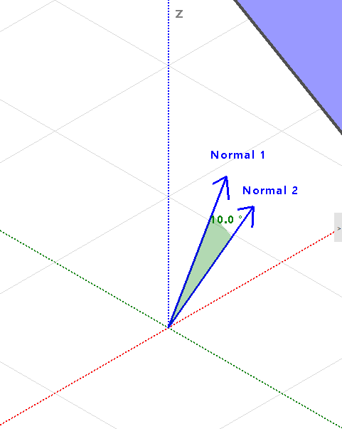

A side-by-side comparison of two panels is displayed, where initially, both panels share the same orientation and normals. Adjusting the inclination of one plane illustrates how its normal vector- and thus its orientation - changes relative to the other panel.
For instance, if the inclination of the first panel is changed to 20°, the difference between the normal vector reaches 10°.
The result of the normal vector after applying the base slope is illustrated in the "Base Slope" tab.
If we start with a nominal inclination of 30°, an azimuth of 0° and adding 5° to the base inclination, the real inclination azimuth box shows values that are slightly different from the nominal plane.
For another example, if we set an inclination of 1° and apply a base slope of 5°, the real azimuth become 78.7°, whereas with an inclination of 20°, the real azimuth drops to 13.5°. This is because we measure the normal vector to the PV plane.

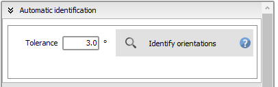

As for an imported scene, a nominal inclination of 20° and an azimuth of 0° is defined with a specific topography. PVsyst generates different orientations with a tolerance of 1° between each nominal vector. In practical applications, wiring each panel based on slight orientation differences identified by PVsyst is not feasible. To address this, PVsyst allows users to adjust the tolerance for normal vector identification, effectively reducing the number of unique orientations and simplifying project planning.
1. Adjusting Tolerance: Increase the tolerance parameter in PVsyst’s orientation identification settings. This adjustment groups panels with minor orientation differences together, streamlining the installation process.
2. Applying Changes: By setting a tolerance, for example, of 20 degrees and selecting Identify orientations, PVsyst consolidates panels under fewer orientations. This simplification is crucial for efficiently managing large-scale installations across uneven terrains.
